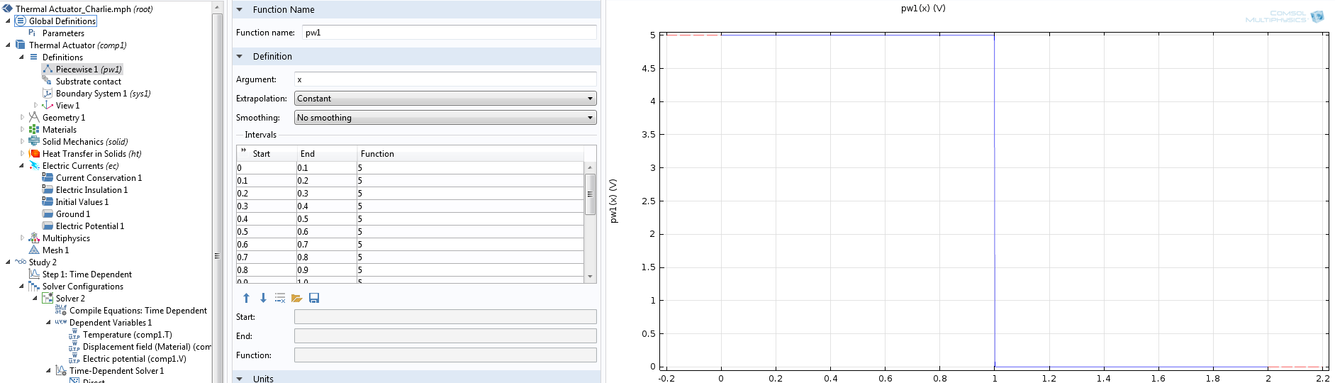

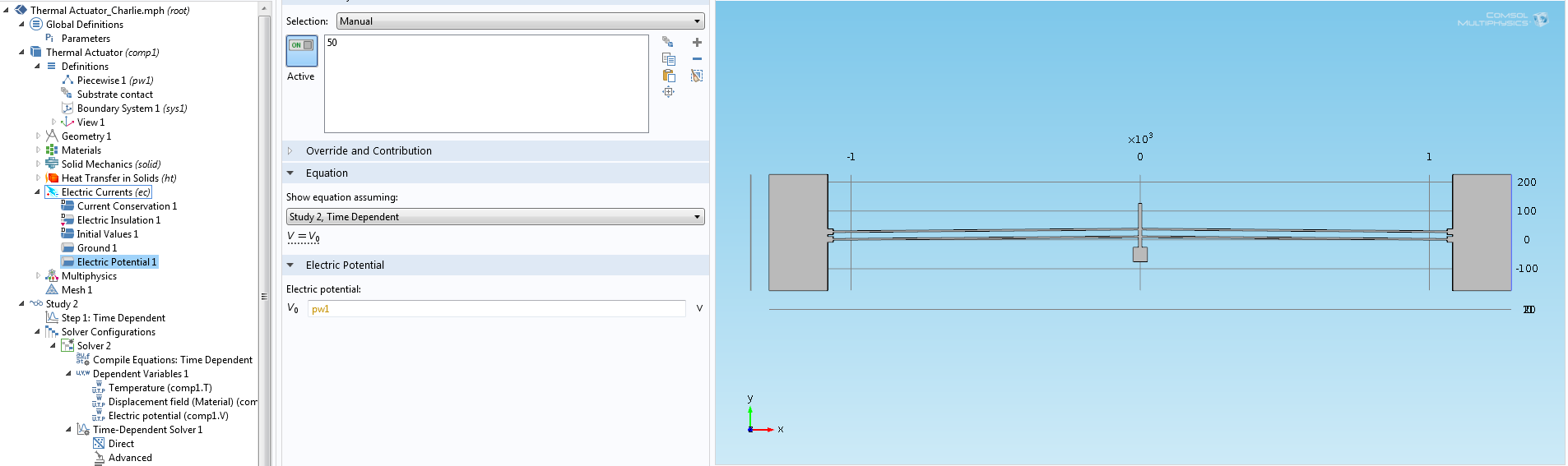

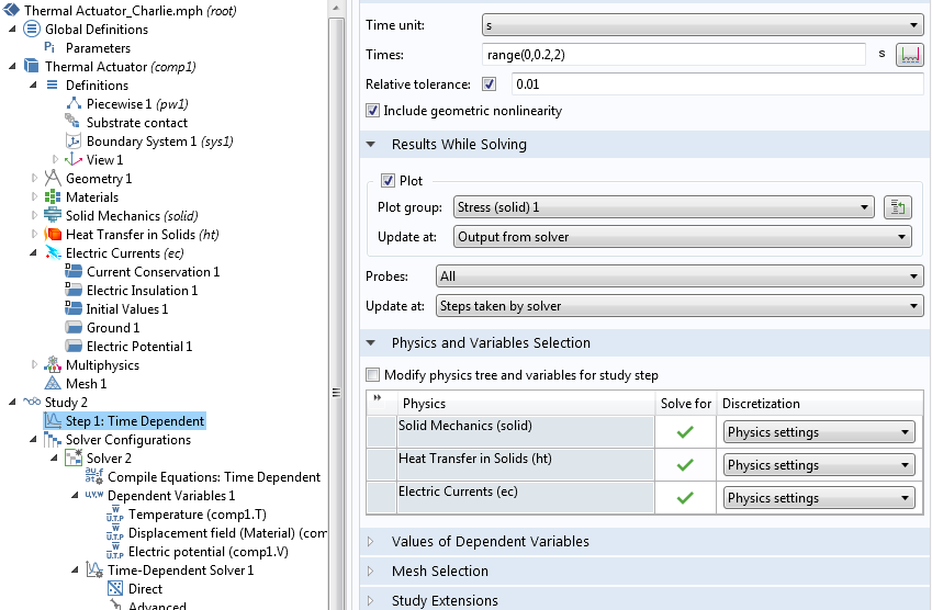

Thank you for your answer. I appricate your help. Now, I define a piecewise funtion to apply a time dependent voltage. However, when I set the electrical potential is pw1 (whichi is the piecewise function), I can not get the result since 'failed to evaluate variabe'. The time dependent study is set as range (0,0.2,2) unit is s. Please see the images in the attachment. How can I apply this piecewise function as a input voltage?
Best, Charlie

How about use pw1(t[1/s])?
Thanks.
Kim
Hi, How about use pw1(t[1/s])? Thanks. Kim
