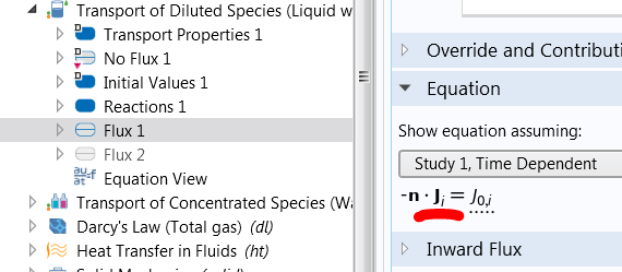

Hi Lasse,
I am using transport of diluted species with convection and diffusion in the conservative form. There is a constant inwards flux of the species at the boundary. My question is about the default expression for the flux j inside the domain. In my understanding if I have convective and diffusive transport in the domain then, flux at the boundary j_0 = -D(gradC)+uC The expression in comsol states n.j=j_0 In the earlier versions the j in the 'Transport' was defined as -D(gradC)+uC In the new version is only diffusive flux (Screenshot attached)?
Mayuri
Hi Lasse, I am using transport of diluted species with convection and diffusion in the conservative form. There is a constant inwards flux of the species at the boundary. My question is about the default expression for the flux **j** inside the domain. In my understanding if I have convective and diffusive transport in the domain then, flux at the boundary j_0 = -D(gradC)+**u**C The expression in comsol states **n.j**=j_0 In the earlier versions the **j** in the 'Transport' was defined as -D(gradC)+**u**C In the new version is only diffusive flux (Screenshot attached)? Mayuri
