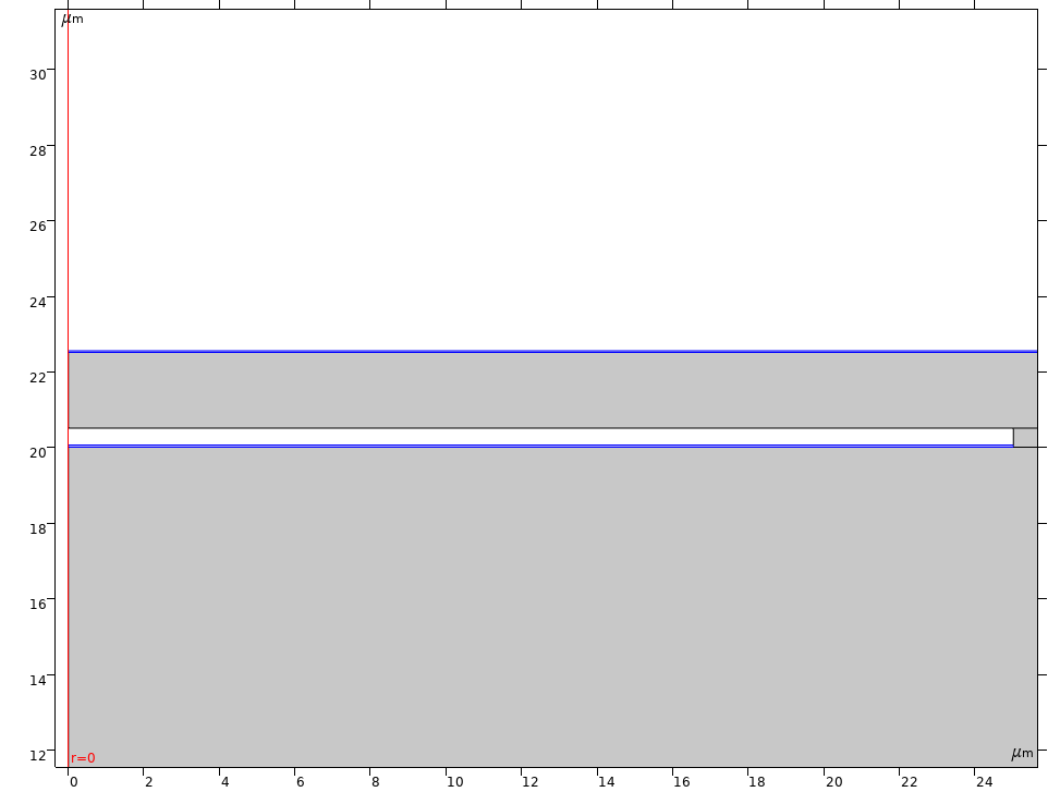

As written in the title, I'd like to know how to simulate the electrostatic attraction between two charged plates only using "Solid Mechanics" and "Electrostatics" modules? I know it can be done using MEMS module but I don't have its license.
Please refer to the attached simple example file.

Add a Force Calculation subnode. It is in Electrostatics, quite obvious?

Hi, Edgar .... Thx for your guiding. It works and save my $ as well.
