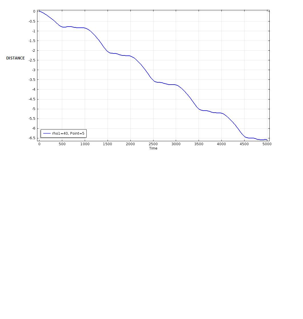

I ave some prolems with your equation and the notation (variable naming)
If I read your right you have gravity along Z (probably in 3D) then you write an equation in X, but be aware x,y,z,r,t as X,Y,Z,R and many more are already used by COMSOL. So if you add something name it such to distinguis it from the COMSOL naming.
Then if you want a vector solution you need 3 global equations one for each direction

Thank you very much Dr. Ivar.
Actually the problem was in axisymmetric. So using X did not affect R and Z ( I suppose).
In my 2D simulation I replaced equations with
Qt-Qdot
Qdott-(f_x)/m.
So Q did not affect any existing notations. My problem is as you know flapping like a pendulum. After simulation the graph Q versus time shows distance versus time.
My oscillation was one dimensional but involving to and fro motion.
Please see the attached picture. Actually when the body returns, displacement should be subtracted from distance. I expected a sine wave horizontal to time axis. But I get a sine wave along the diagonal. I suppose that this is distance versus time graph and not displacement versus time graph, which shows accumulated displacement which keeps increasing with respect to time. Am I right?
