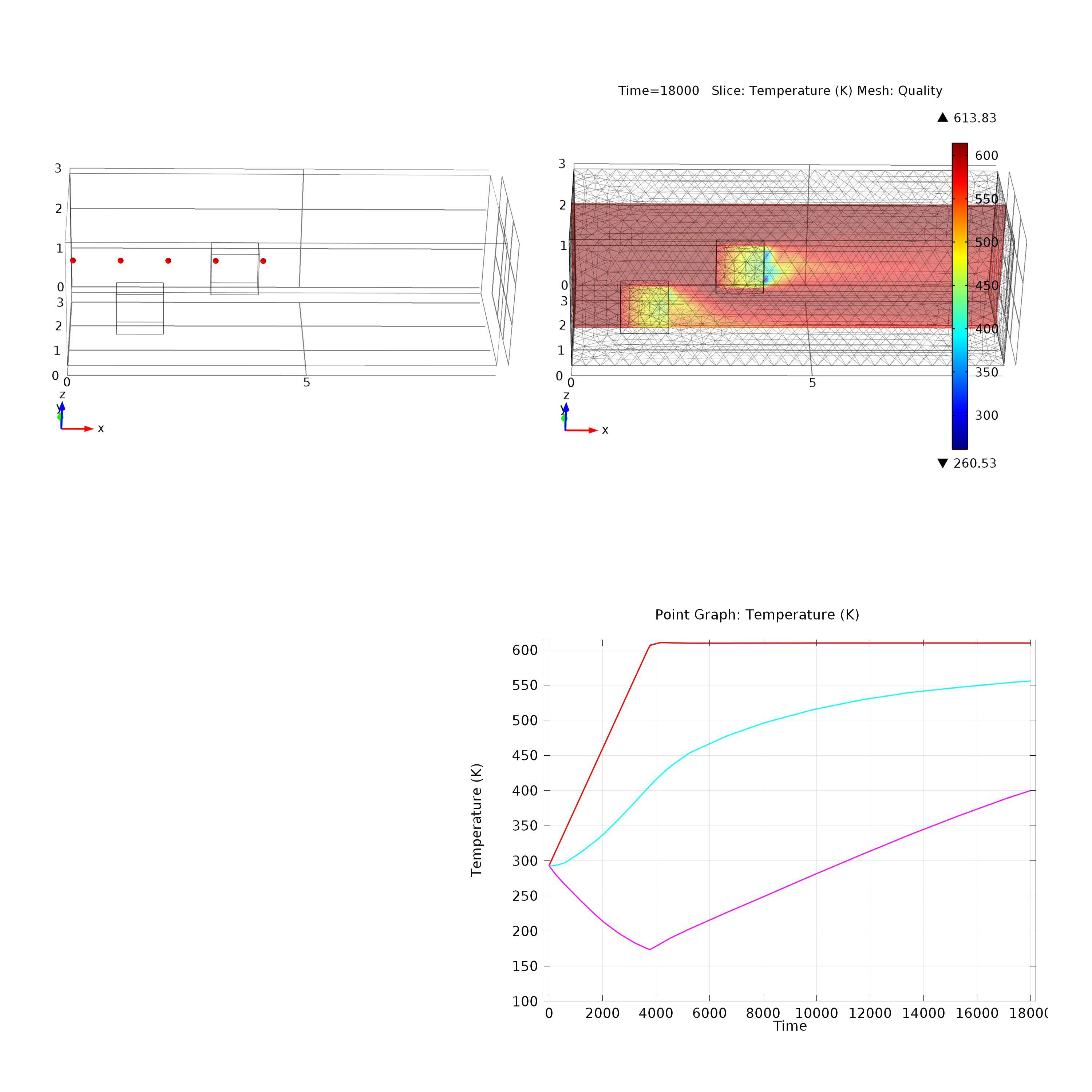

I've made a model for an autoclave with 2 blocks in it that should heat up during time. They however first cool down to like 200K and after they start to heat up again. That's not what i suspect and what is realistic. Since the model with results is to big i will upload only the model. It isnt that big so should be computable in short time;). (comsol 4.2a)
See the attachted image.
hope all is clear.
Thanks in advance!

I've added the outflow condition but is still gives me the unexpected decrease in temperature.. The previous results were deleted. I also Included a results graph and empty model.

What is going wrong?

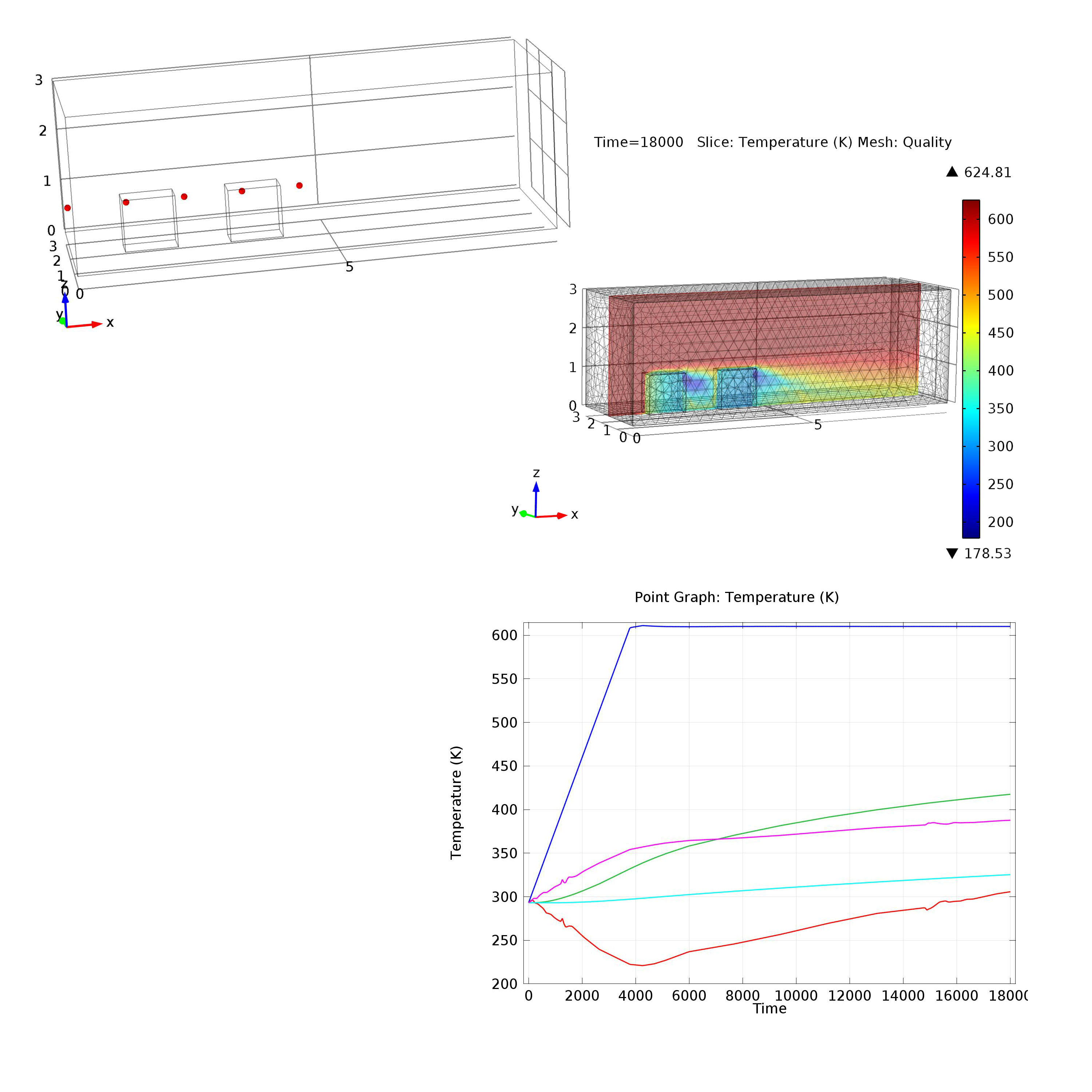

I tried both but i now gives me some strange errors.
What is going wrong, i somehow cannot find the error

I have made a certain numebr of changes in the model hereby, I had to reset it and clear the solver settigns, could be an 110-166 patch issue, I can only suggest that you get latest patch up, as there are a few fixes
There is something funny in your file, its stuck in turbulent, something is not correctly reset, I would suggest to restart from scratch
