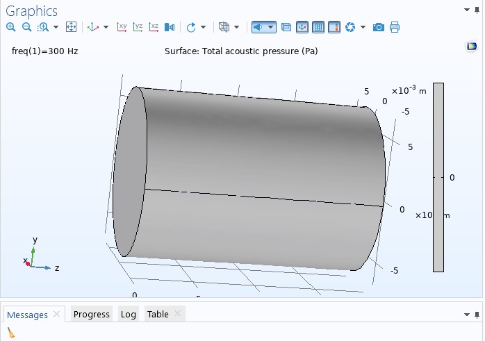

Hello everyone I have a problem with my work. I want to simulate the variation of frequency in a porous material, but there is no variation appearance of my work. There is nothing. How can I do?
1 Reply Last Post Dec 7, 2021, 7:27 a.m. EST
Posted: 4 years ago Dec 7, 2021, 7:27 a.m. EST
For this 3D plot you typically look at one frequency only. If you want to look at a frequency response, you make a 1D plot.
