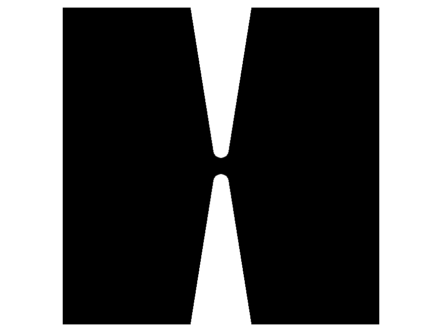

I have a geometry of spin Hall nano oscillator. I have calculated current density distribution in the device by Electric Currents module. I exported that data also. Now I want to calculate the current indused magnetic field due to this current density deistribution. How can I do this? I have tried external current density node in Magnetic Fields module but it takes only uniform current density. I want to import current density which I have already calculated. Thanks
