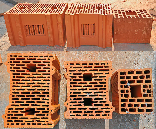

I modelled the heat transfer within a block with some air gaps. In the model, heat is transferred by conduction in the solid domain, and in these air voids, convection and radiation are also involved. I have attached a picture of the block.
That problem is that the computational process is extremely slow. With very coarse mesh, it takes nearly 2 hours to get the simulation result.
I then refined the meshes for the air gaps to improve the accuracy of convection, and resolve the problem. After 4-hour computation, the solver sent this message;
Failed to find a solution.
The relative residual (0.28) is greater than the relative tolerance. Returned solution is not converged.
I don't think the heat transfer within a block will be a very complex model. It is astonishing to see COMSOL takes such a long time to solve it. My laptop is Macbook pro with Intel i7, 4GB RAM. Are there any problems in my model or is my laptop not powerful enough to run COMSOL?
Can anyone help me?

the only point where I suspect you are wrong, is that heat transfer, including convection and radiation IS complex, and particularly non-linear, probably your coarse mesh is even making things worse, and you do probably not have enough RAM to include a much finer mesh.
You should rather ask yourself if you can simplify the problem. i.e. use 2D instead of 3D, remove radiation and even convection and use a simpler energy exchange to start, then add them one by one

If you are modeling radiation using the surface-to-surface radiation feature then that can really slow down your problem. It increases the problem size and its nonlinearity but specially its size. Start with removing that if you have it, and also follow Ivar’s suggestions.

Yes, you're right. After I add the surface-to-surface radiation part, the solution was obviously slowed down. Do you mean that I can simulate the model without radiation at first, and then go to the solver manager, change the initial value to current solution. After adding the part of radiation, simulate the model again? By the way, if I compute the model in this way, is the result the same as the model which simulates radiation, convection and conduction at one time?

If you solve the problem in the two steps you described the final solution should be the same. Convergence may be easier to reach, however, the second step will still be slow. I’m not sure what surface-to-surface radiation features where available in version 3.5a that you are using, but in 4.3 there are options within surface-to-surface radiation that simplify and speed up the radiation calculation.
