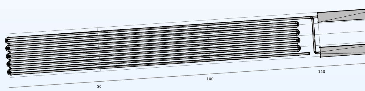

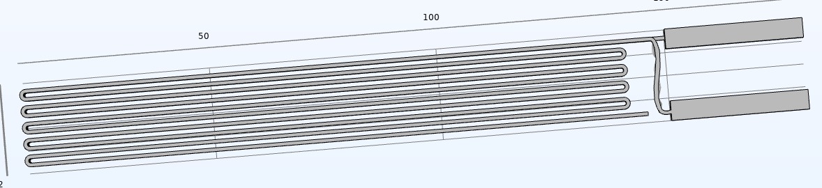

Hi everyone,
I've got a simulation where I have to simulate the behaviour of different models in the same scenario. So i put on a simulation, which works great with 3 out of 4 models. The 4th model is causing some problems with importing the .stl When importing the .stl the geometry doesn't look like it should. And when the second part of the model is added (one model contains two geometrys) then there are errors caused because the bodies don't fit together. I'm just confused of the fact that the Mesh that is imported from the .stl is perfectly fine in Comsol. It's just corrupted in the geometry-section and i have no idea how to fix that. I'll upload pictures of the Mesh and the Geometry for to demonstrate. Anybody an idea, how I could fix that?
Thanks!
