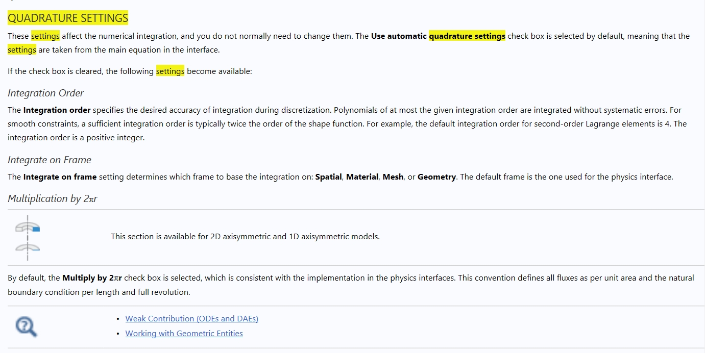

When use weak form PDE interface to perform modeling on axisymmetric geometry, I encounter a setting named 'Quadrature Settings'. It is explained in the decumentation as
After read this, I am still confused. If I 'Use automatic quadrature settings', would the weak expression I input be multiplied by '2pir' automatically? For example, which one should I input as the weak expression, 'q*w', or '2*pi*r*q*w', for a distributed force, if 'Use automatic quadrature settings' ?
