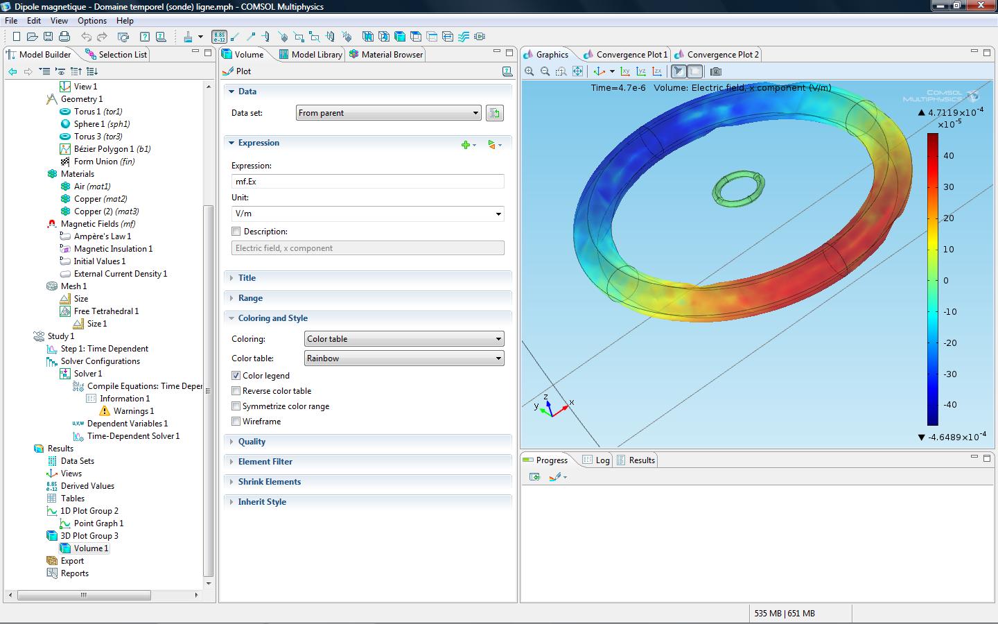

The 3D model's dimensions are a 0.02m radius copper torus, another 0.003m copper torus in its middle and 0.1 air sphere.
The point : I'm exciting the first big torus with a current to generate a magnetic field. And I want to know the effect of this magnetic field on the little unexcited torus by calculating its value and the value of the V in its borders. This why I need the magnetic field and the voltage. What I've done is to open the revolution angle of the little torus to 350 and create a besier polygon between its borders which will serve as a line integral of the Electric field, which means the V. But so far I have a probleme meshing the model since I have an "out of memory"error with a normal mesh and an "edge is much shorter than mesh element" error with a coarse mesh...

The problem is that when I run the simulation and I pot the Electric field, the inner little torus doesn't seem affected by the outer torus' fields since the electric field is null there. Like it's shown in the attached file.
When I simulate the V voltage it's even a worst problem since no torus seem to have a voltage. Also attached.
What's wrong in my approach please ?

It is hard to tell what is wrong with model setup without seeing it. I am attaching test model2s (2D axisymmetric and 3D) where time-dependent current in the large torus creates induced field in the small torus.
Sergei
Unfortunately, I'm using a 30 trial version of Comsol 4.3 (but I'm urging my university to buy a licence) and can't open your attached files, I got an error message.
Can you please attach the report or precise screenshots of the 3D model at least.
Thanks again and sorry for the inconvenience
