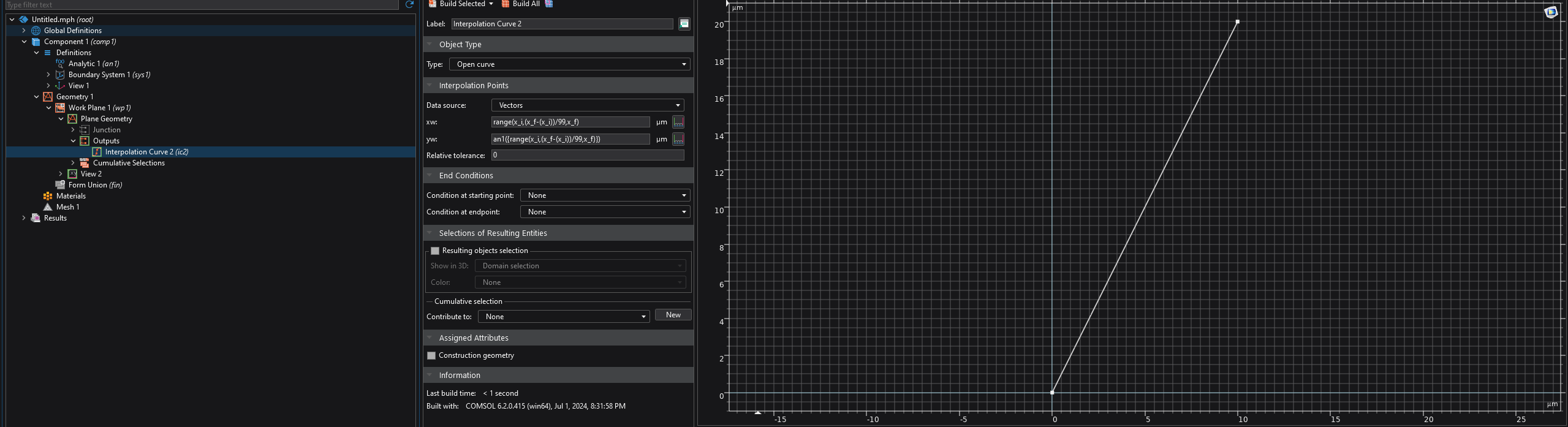

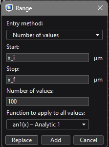

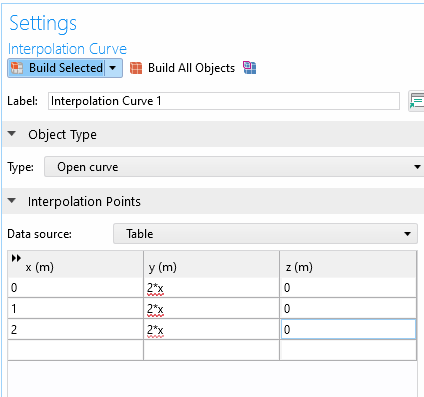

The doc on anlytic functions as well as interpolated curves is a bit thin. After making your analytic function, in Component-Definitions-Functions making sure to set the units appropriately, you could then call the function either by manually typing in an1(0), an1(1)... But I would guess that you want a smooth function. To achieve this, change the data source to vectors, and set a range for x, and then set (probably) the same range for y but this time choose the function at the bottom of the window. Hope the the screen captures help.

Using a Parametric Curve instead of an Interpolation Curve might be a better approach in this case.
