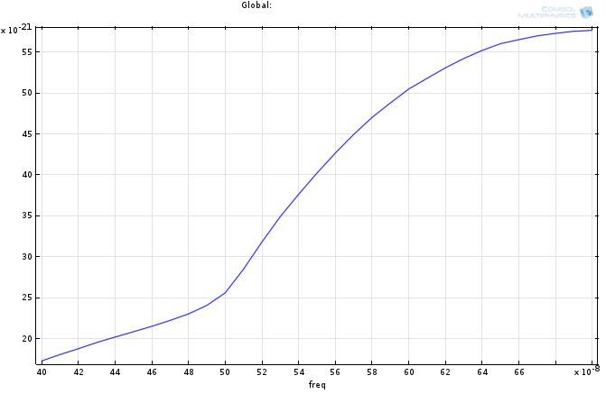

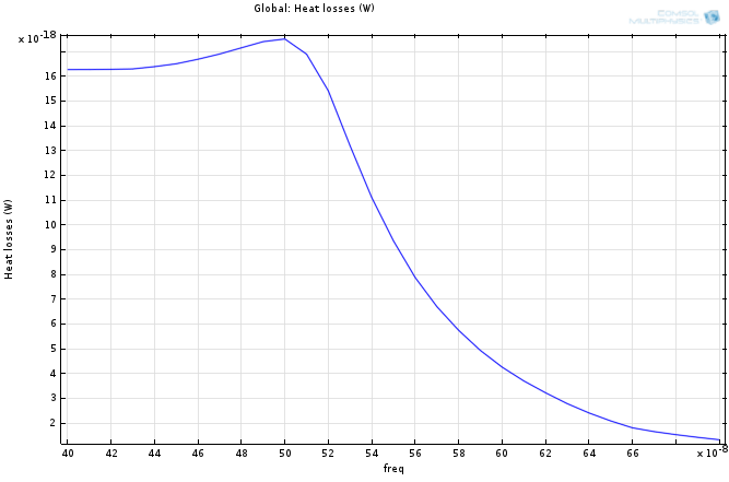

Posted: 1 decade ago Jan 27, 2013, 4:22 p.m. EST
Hello Yevgeniy,
I have received some emails asking me if I was already able to plot the absorption and scattering cross sections of a gold sphere, so I know that this is a topic of general interest. As I said in the last post I was already able to obtain a resonance peak of the scattering cross section. Nevertheless the values don't correspond to the Mie values obtained for the COMSOL 3.5 version. I send an attachment with my results and the expressions I used.
I only defined in Parameters: E_inc as 1[V/m] and introduced the expressions for the cross sections in Definitions - Variables.
You can see the expected and obtained results, together with the expressions I used. Can you please comment on these for the general community? We would all appreciate.
Best regards,
Hello Yevgeniy, I have received some emails asking me if I was already able to plot the absorption and scattering cross sections of a gold sphere, so I know that this is a topic of general interest. As I said in the last post I was already able to obtain a resonance peak of the scattering cross section. Nevertheless the values don't correspond to the Mie values obtained for the COMSOL 3.5 version. I send an attachment with my results and the expressions I used. I only defined in Parameters: E_inc as 1[V/m] and introduced the expressions for the cross sections in Definitions - Variables. You can see the expected and obtained results, together with the expressions I used. Can you please comment on these for the general community? We would all appreciate. Best regards,

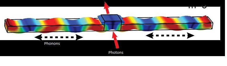

Dear All
i hope that you are well, thanksssssssss allot for these information, i want to simulate the brillouin scattering in a silicon nano-wave guide surrounding by air, the idea is the interaction between the optical field withe the acoustic wave inside the silicon wave guide i.e the interaction between the pump wave with Stoke wave, please if you have any suggestions, should i use PDE or PMl or other thinks to simulate the scattering.
Best Regards
Dear All i hope that you are well, thanksssssssss allot for these information, i want to simulate the brillouin scattering in a silicon nano-wave guide surrounding by air, the idea is the interaction between the optical field withe the acoustic wave inside the silicon wave guide i.e the interaction between the pump wave with Stoke wave, please if you have any suggestions, should i use PDE or PMl or other thinks to simulate the scattering. Best Regards
Posted: 1 decade ago Mar 13, 2013, 11:40 a.m. EDT
The only question is:
How will you define optical properties of your waveguide?
If you for example, you are solving Acoustic-structure interaction in time-domain and obtaining time-dependent density variations, then you can couple it to stationary RF model where optical properties of your waveguide is density dependent (analytical function n(ast.rho(time)))
The only question is: How will you define optical properties of your waveguide? If you for example, you are solving Acoustic-structure interaction in time-domain and obtaining time-dependent density variations, then you can couple it to stationary RF model where optical properties of your waveguide is density dependent (analytical function n(ast.rho(time)))

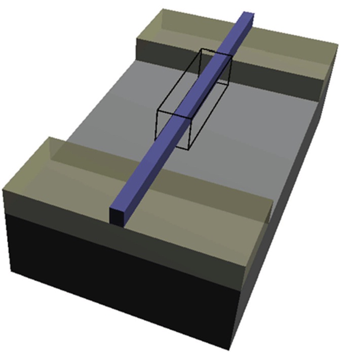

Posted: 1 decade ago Mar 14, 2013, 5:54 a.m. EDT
Dear Davletshin
thanksssssssss allot for your reply, i will attach to you my model, in simple words it is the interaction between the optical field (photons) and the acoustic field (phonons), so light (pump photons) will be scattered by the phonons (stoke), this is called brillouin scattering but how can i model this, i can not find it until now, i just get the optical mods but not the acoustic modes.
Best Regards
Dear Davletshin thanksssssssss allot for your reply, i will attach to you my model, in simple words it is the interaction between the optical field (photons) and the acoustic field (phonons), so light (pump photons) will be scattered by the phonons (stoke), this is called brillouin scattering but how can i model this, i can not find it until now, i just get the optical mods but not the acoustic modes. Best Regards

Dear Davletshin
i attached to you the wave guide pic just to see it and may it helps you to think in way with me to solve the problem.
best regards
