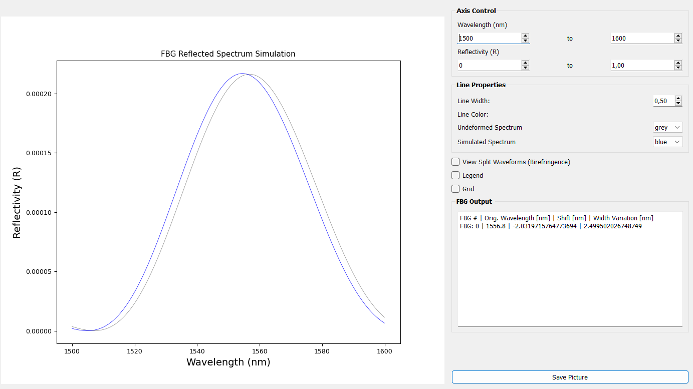

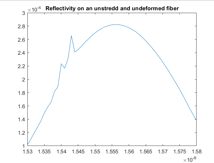

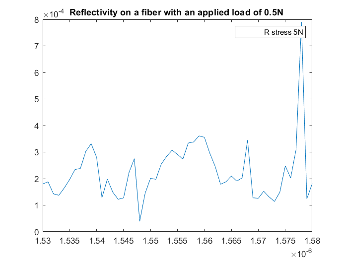

The results i obtain (attacched) don't match with the theorical result and with the results i obtain in FBG-SimPlus (also attached). Anyone can tell me what i am doing wrong? Are the equations wrong or is the entirety of the approach?
