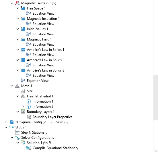

Moving down to the magnetic fields interface, I noticed that when placing the node in, free space, magnetic insulation, and initial values are all defaults. Moreover, the magnetic insulation component selects every face inside the box (which is meant to be a magnetically permeable material) and the box itself (which is air). I add in Ampere's Law in Solid's to select the parts inside of the box that are supposed to conduct magnetic fields with the selection "Magnetization" highlighted with a given material magnetization, but when I run my simulation, I run into an issue where the flux is near zero (on the order of E-16 teslas) which makes sense because the tangential component of the fields on the parts of the model that are supposed to conduct magnetic fields are forced to zero; given Gauss' Law for magnetic fields the magnetic field should be zero. Therefore, the fields don't permeate outside of the model.

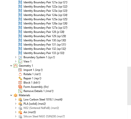

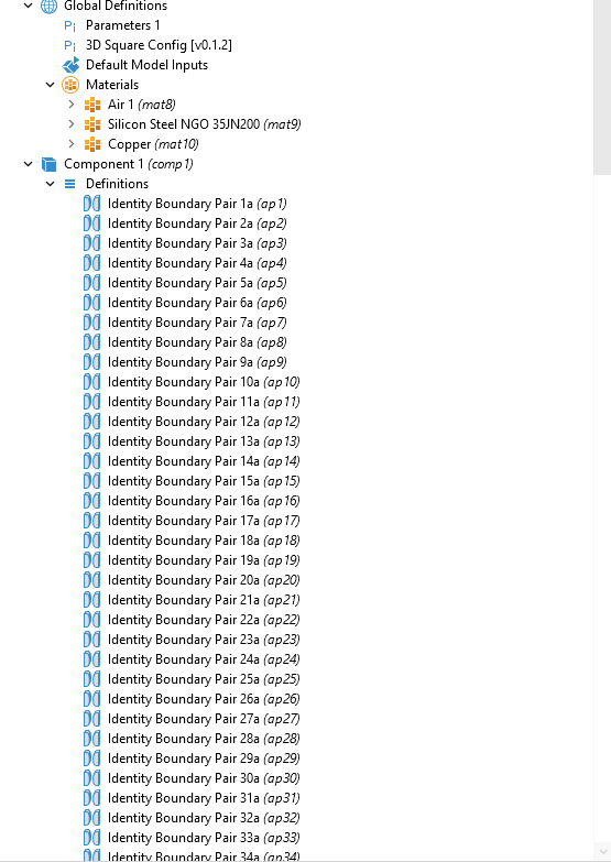

Given that, I went and checked under "Definitions" to see the Identity Boundary Pair, and it made pairs between each of the components in the assembly. After running it again (where the Magnetic Insulation is still selecting everything inside the box), I run into the same issue. I then try to implement a Continuity Boundary in the Magnetic Field's interface, and I see that all of the components inside aren't selectable (it says "not applicable"). So i then try to select all components inside of the box and add a Magnetic Field's boundary condition, assuming that COMSOL will recognize that if I keep the initial parameter of the boundary condition of the tangential magnetic field to be zero, it will allow the magnetization to conduct in the material.
I either get an error message that says: Divergence cleaning failed for Auxiliary-Space Maxwell (AMS), or I run into the same issue where the magnetic flux doesn't permeate out of the material inside the box of air, and the magnetic field is still around the value of E-16 Teslas (essentially zero).

I attached a picture of my Model Builder Hierarchies, however, I'm not able to link my COMSOL model due to privacy concerns. Could anyone help me?
