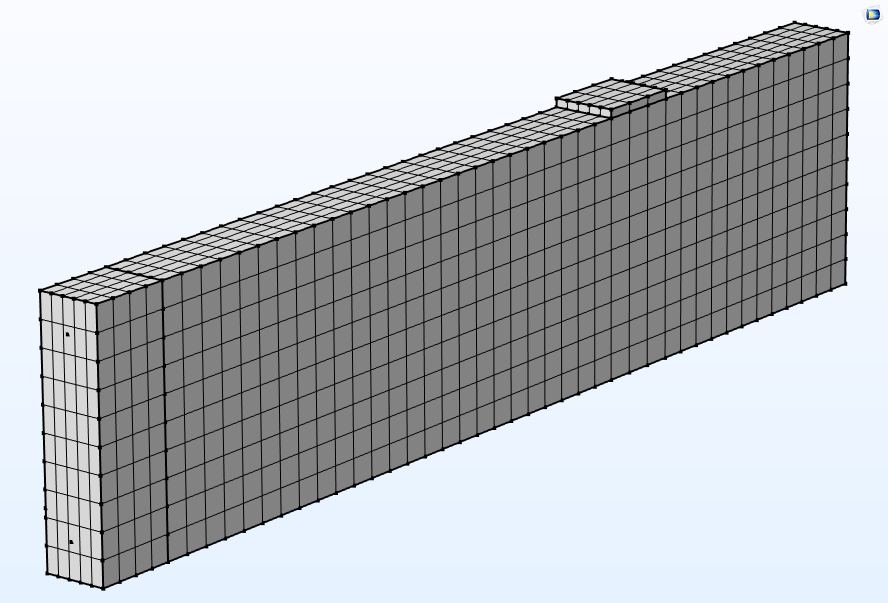

  • Improve the mesh, see attached image for the mesh I used.

How did you mesh this mesh with the tendons? Also there is no symmetry with these tendons!.
