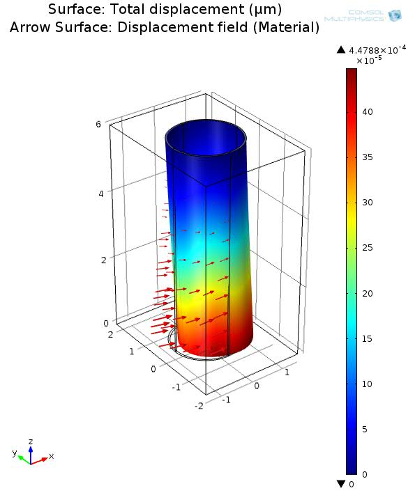

                                                    Thank u fr the reply...but i did not understand what 'Dz(r)' and ' r ' mean in the relation, could you be more precise on that..actully i am designing a nanotube sensor of length 6 um, radius of 1 um and thickness of 50 nm...i have also attached snapshot of nanotube.

                                                    hi,
    still i am in confusion, what should i put for ' r ' in the first equation??....why negative sign in first equation?? i am applying pressure onto one of the boundaries of nanotube in x -axis direction.
                            hi,
