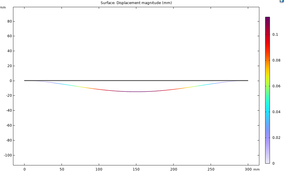

Why does 2D static deformation plot show displacement magnitude smaller than the Y-axis displacement?
In this model, the color-scale (displacement magnitude, ~0.1mm) deformation does not match the XY spatial deformation of the plot (~20mm). Can someone help me understand how the displacement magnitude is different from what is plotted in XY space?

Hello T,
It's because a scaling factor is applied to the displacements to render them visible in the graph. See, e.g., this thread or this one, etc...

Hello T,
