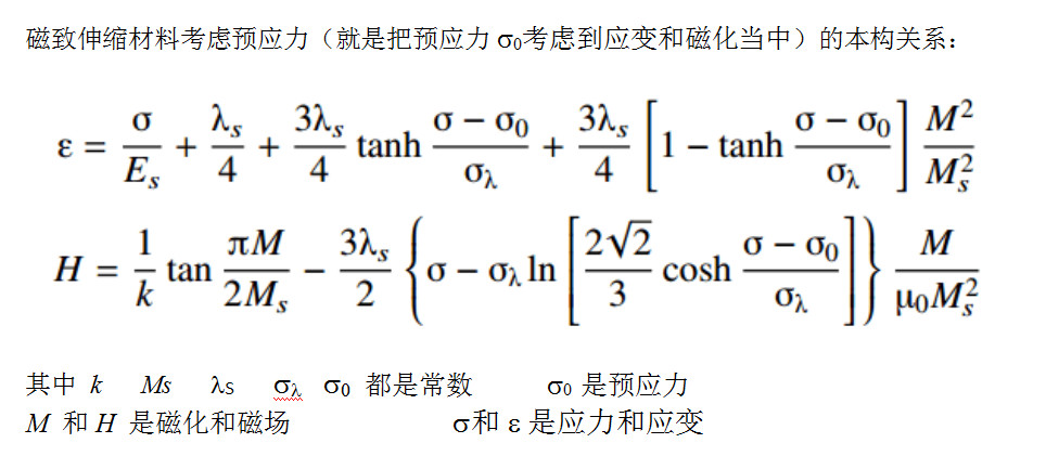

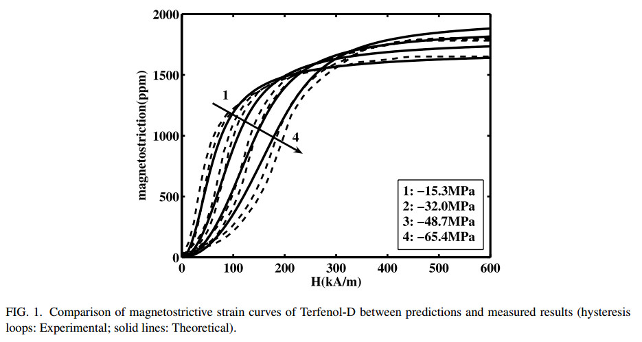

Hello, I'm also study magnetostrictive material, I want to study the nonlinear coupling stress constitutive, can you add my QQ contact 383156448 or email : sxycyzhj@sina.cn
thank you
