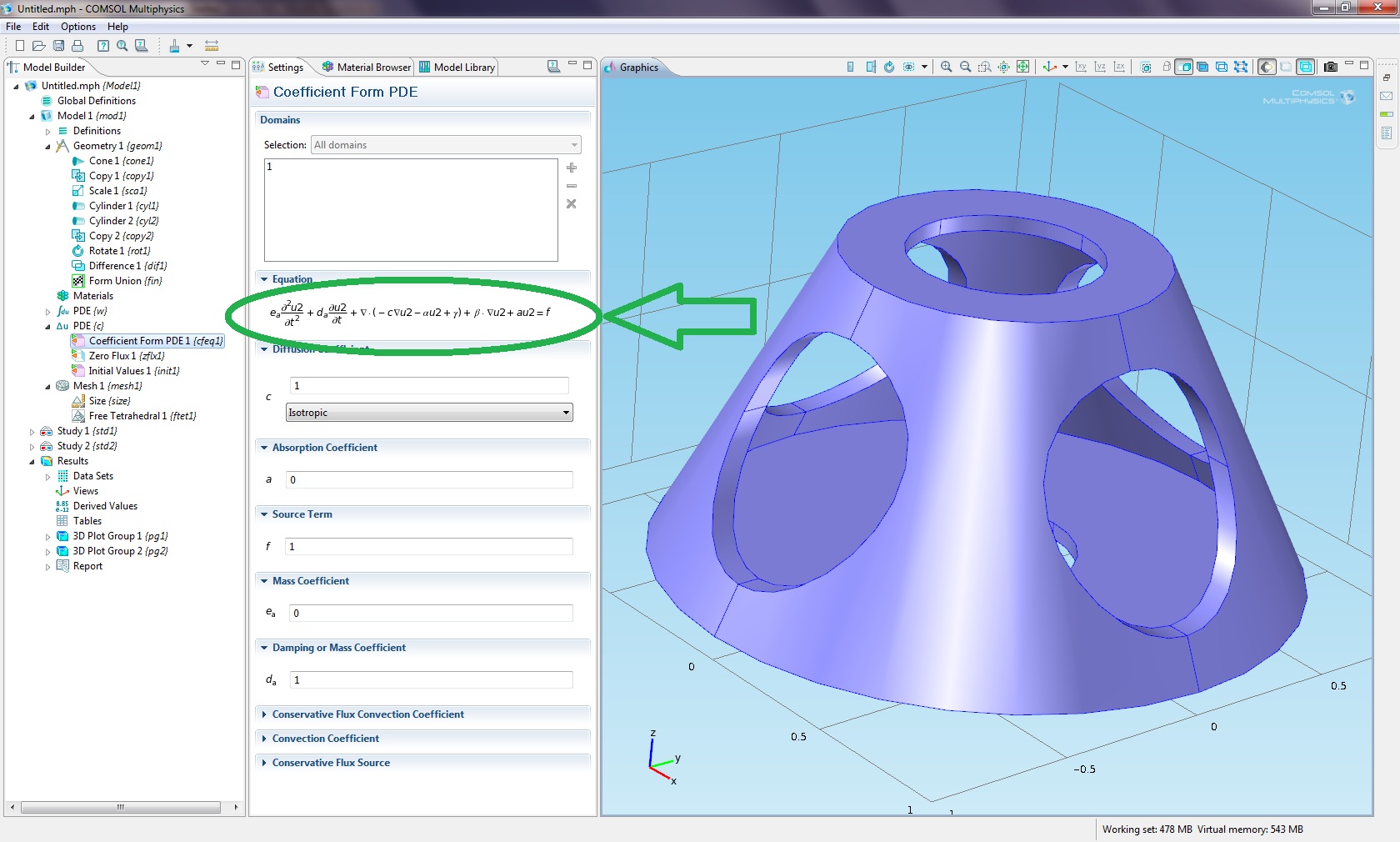

One exception to the above is the Coefficient Form, General Form and Weak Form application modes (all of which continue to be available in 4.0 BTW). For those, the equations are indeed displayed in the graphical user interface. I am attaching a screen shot showing this for Coefficient Form.
