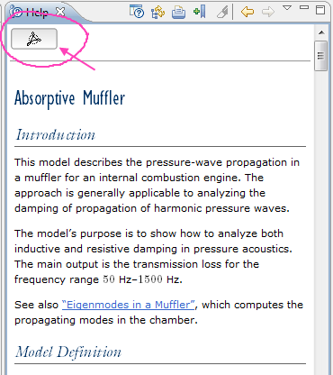

- All models are documented in the help system and as individual PDFs. You can find the PDFs the following way: Click the Dynamic Help button. Select File->Open model library. In the Model Library windows, select the model you are interested. Now find the Related Topic in the dynamic help window. Click the Model name. You now get a PDF button (see attached screenshot pdf.png). This will be much easier in version 4.0a, where you will be able to click the button directly in the model library window.

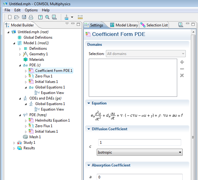

- Equation (PDE) display is planned for a later release (4.1). As you already noticed the equations are available in Equation View but are generally written in weak form. In 4.0 you can find the continuous PDE formulations in the Mathematics interfaces. (See attached screenshot pde.png)

Hi Naveed, - All models are documented in the help system and as individual PDFs. You can find the PDFs the following way: Click the Dynamic Help button. Select File->Open model library. In the Model Library windows, select the model you are interested. Now find the Related Topic in the dynamic help window. Click the Model name. You now get a PDF button (see attached screenshot pdf.png). This will be much easier in version 4.0a, where you will be able to click the button directly in the model library window. - Equation (PDE) display is planned for a later release (4.1). As you already noticed the equations are available in Equation View but are generally written in weak form. In 4.0 you can find the continuous PDE formulations in the Mathematics interfaces. (See attached screenshot pde.png) Niklas Rom, COMSOL [QUOTE] Hi Ivar Thanks. Are you able to see the general equations in C4.0 or they are also in developing stage? With equation view, i can only see the weak expressions/constraint and not the general (in standard form) equations. Regards Naveed [/QUOTE]

Thanks for the comments. Yes, now I am able to see the (hidden) pdfs of model library. I think, it would be best, if in the upcoming release, the standard physics equation (as read in text books) should re-appear-as they were in C3.5a or earlier. Most of the users are not expert to convert PDEs back to the physical equations for their understanding.
