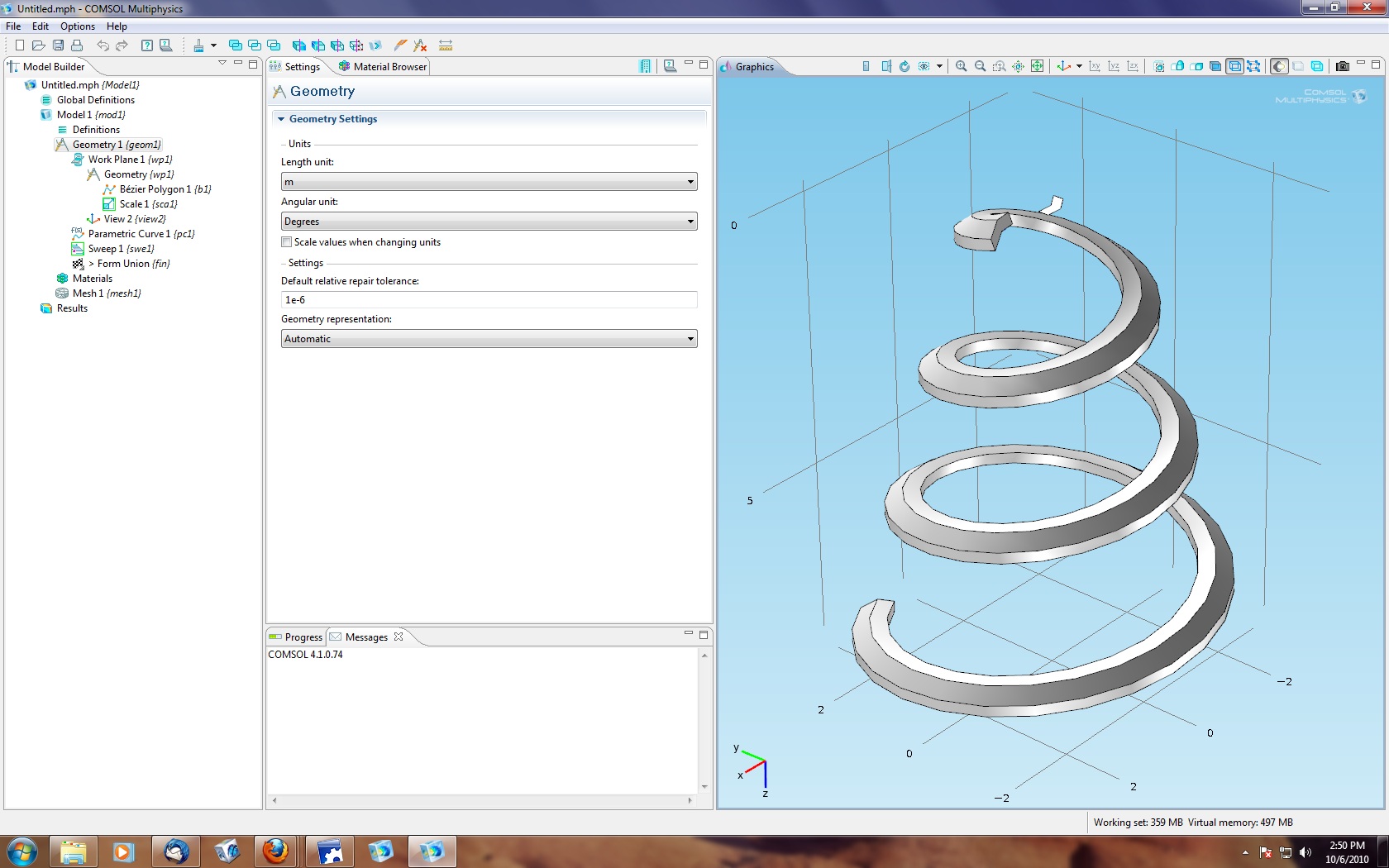

In version 4.1 you can define a curve by its parametrization, for instance a corkscrew can be parametrized by
x=cos(s)
y=sin(s)
z=s
where s is the parameter.
In 2D you can draw a boundary with a cosine shape by
x=s
y=cos(s)
etc.
In addition you can sweep a face drawn in a workplane along a 3D curve. Combining the two features, you can generate objects like the one shown in the attached screen shot, where a hexagonal face is swept along a spiral-like parametric curve.

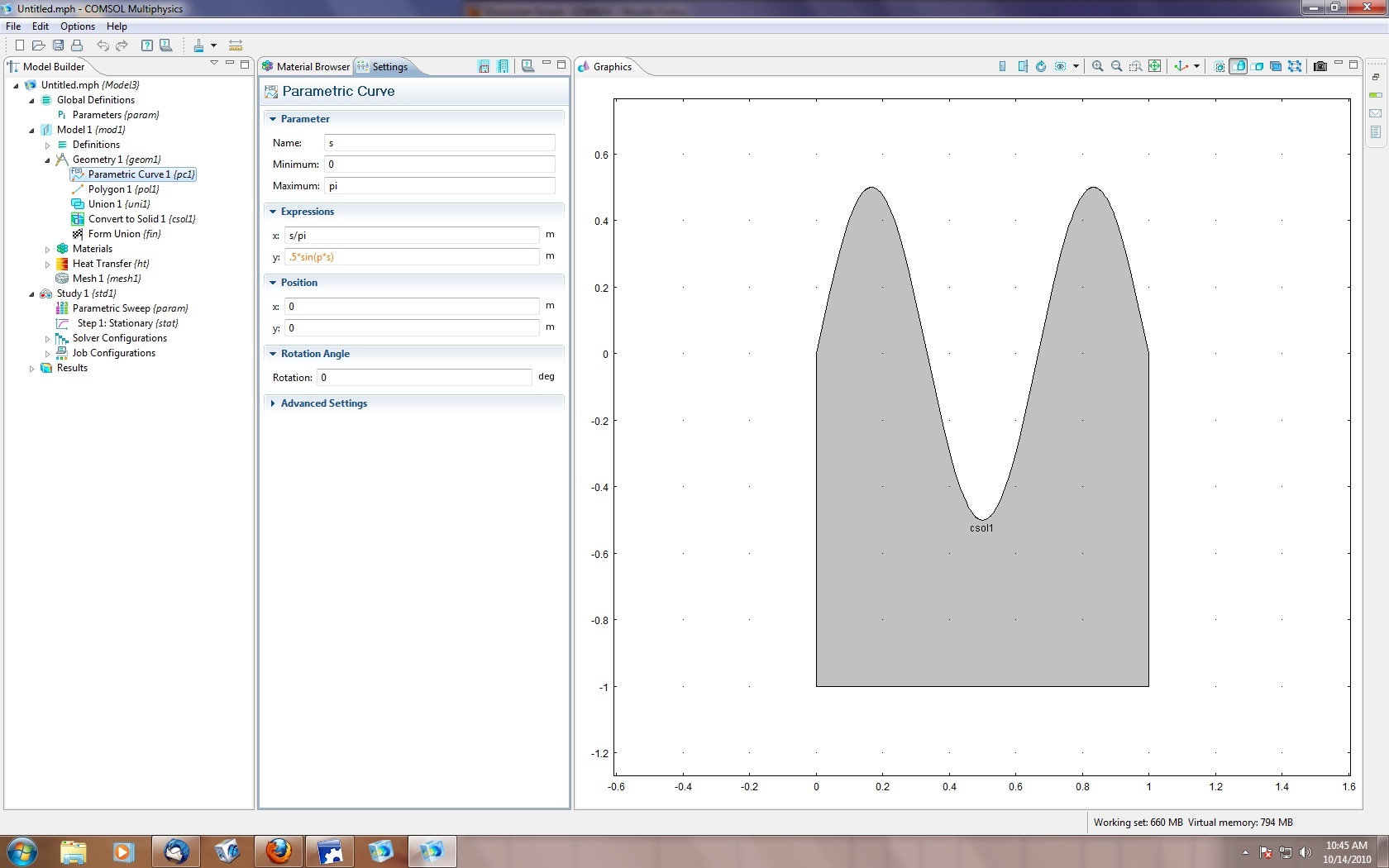

Will it be possible , say in 2d to do geometric parametric sweep with a one parameter family of parametric curve? say x=s and y= cos(p*s) [ stupid example but formally correct]
That will be awesome for I am struggling with matlab script to do exactely that at the moment...
Thanks for your answer anyway
JF
wonder how many JF use comsol...lol
ps this question is practically important for me for if it is yes I will stop working on my scripte waiting for 4.1...
See screen shot, with the geometry showing p=3.
JF
