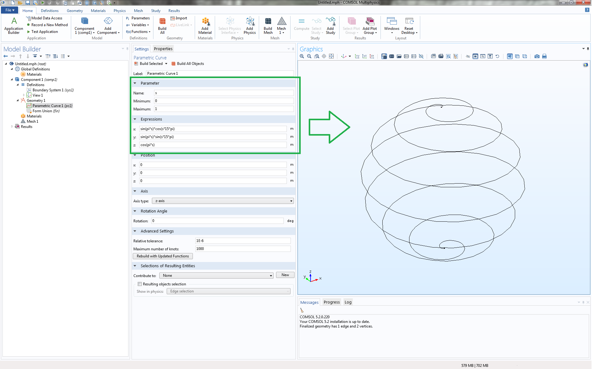

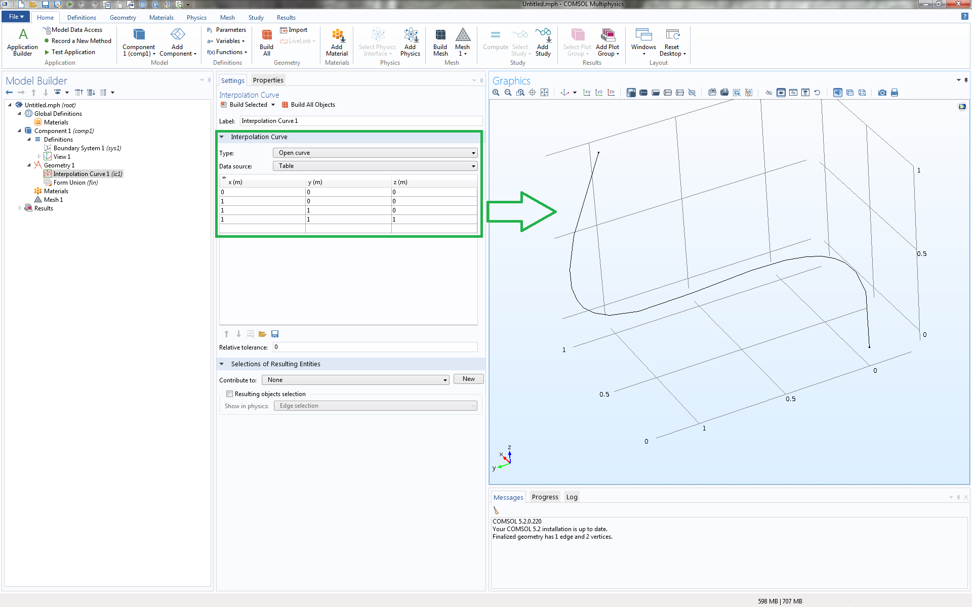

Your work can best be done with the Pipe Flow Module (www.comsol.com/pipe-flow-module), which allows you to model curvilinear pipes as 1D entities, saving you memory and solution time.
These 1D curves can be created in a number of way, the most flexible options being "Parametric Curve" (When you know an equation for the curve) and "Interpolation Curve" (When you know the coordinates of a few points on the curve), and they can be embedded in 3D objects to represent the interaction of the pipe with its surroundings.
