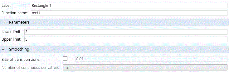

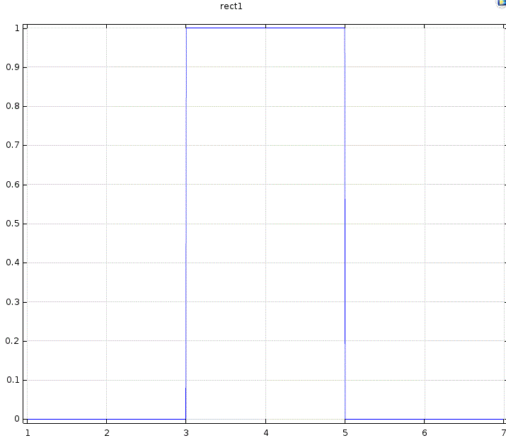

I really agree with your advise.. Here, I have one problem..
I set up an rectangle function shown as attached file which has lower limit of 3 and upper linit of 5.
And I multiplied this rectangle function(rect1) in the reaction text box as : "rect1*R"
However, it seems COMSOL can't recognize the definition of "rect1".
Could you let me know what's wrong here?

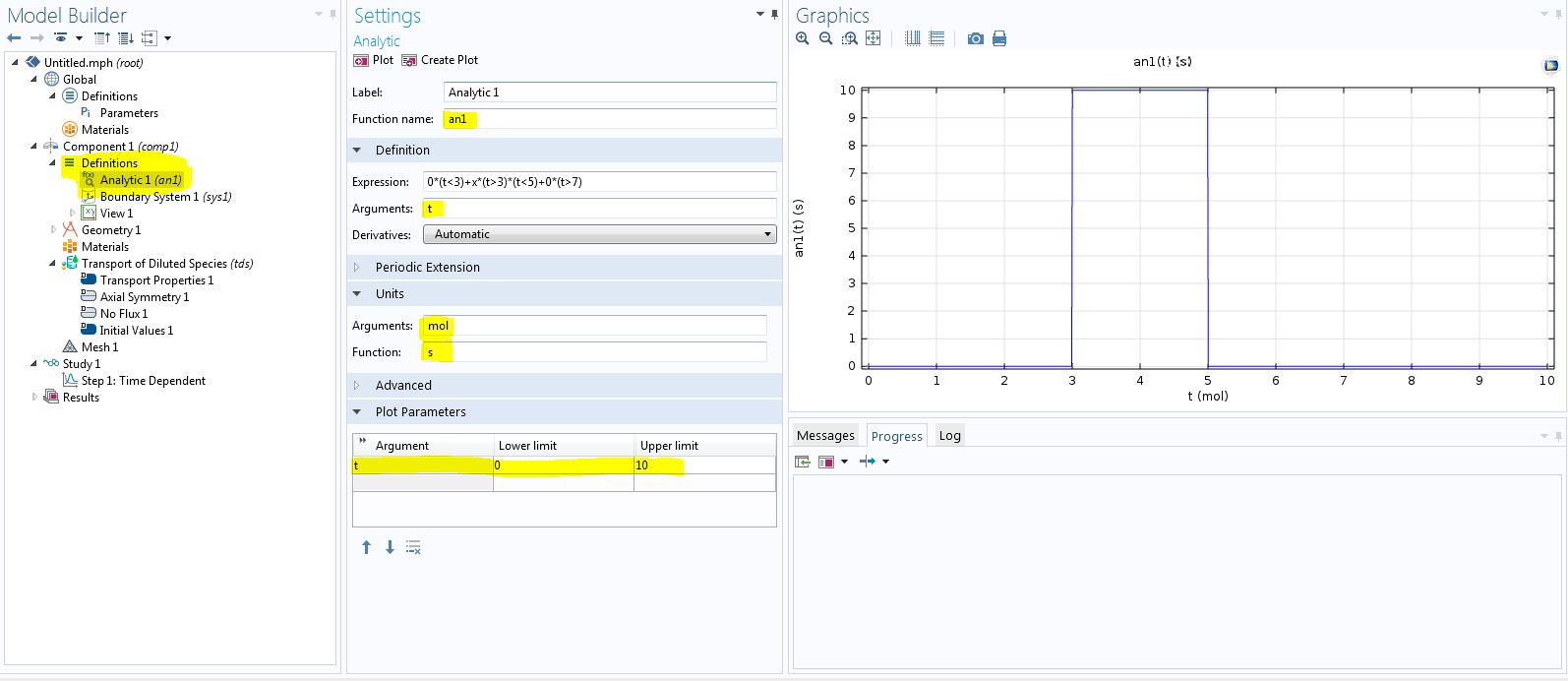

Hi woongsun,
I prefer to implement in the function that you specified in the definition > variable >analytic function , and implement the function equation using an If condition statement. lets call the name of the analytic function as an1, which is time dependent.
Now implement the function as an1(t[1/s]) in the place where you want to implement the reaction.

Hello, Julien!
Thank you for your advise!

Posted: 10 years ago May 6, 2016, 5:53 a.m. EDT
Hi, Krishnaswamy!
Thank you for your reply.
I couldn't find analytic function tap as you taught me.. (the definition > variable >analytic function)
Also, could you show me how to use if condition in analytic function??

Hello Woongsun,
When you call any function in COMSOL, such as your function "rect1", you need to indicate what argument the function takes, for instance "rect1(t)".

Hi woongsun,
I have attached the method of implementation in the jpeg file, you can see the highlighted part in yellow,
I am sorry for explaining you in legitimate way,
so, right click the definition under the component > function > analytic.
I have also highlighted the function name as an1, however you can change it to any name that you like and use it further in your implementation as an1(t[1/s]), this t in the bracket denotes the time dependency in the problem. If you plan to change the function name to func then you need to use it as func(t[1/s]).
