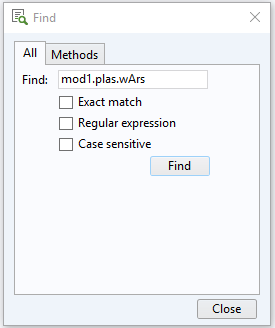

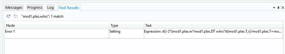

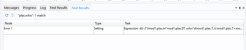

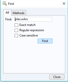

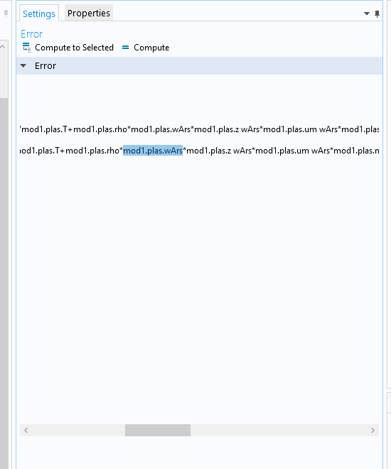

Hi Dear Henrik, Thanks for your answer. But it did not help! I searched some definion but find just in error code! *Please see attached screenshots.
Saluti
Hi Dear Henrik, Thanks for your answer. But it did not help! I searched some definion but find just in error code! *Please see attached screenshots. Saluti

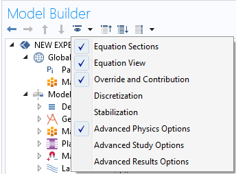

Did you have "Equation View" turned on in the Show button ("eye" icon at the top of the Model Builder) when you ran that search?
Jeff
Jeff Hiller
Did you have "Equation View" turned on in the Show button ("eye" icon at the top of the Model Builder) when you ran that search? Jeff
Posted: 8 years ago Mar 21, 2018, 6:43 p.m. EDT
Dear Jeff, yes! turned on! but still search does not yield any results!
