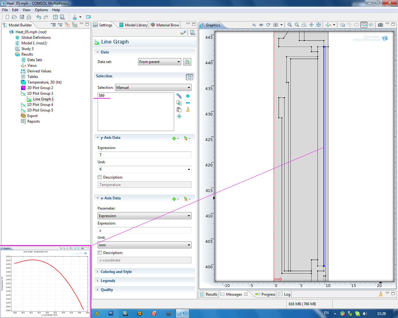

But the thing is that I don’t have to define the function T(z), as it is unknown in the very beginning – it can be acquired only as a result of calculation. I have to assign a variable to the still uncalculated temperature distribution on the element boundary. And then I'd like to use this variable for another function in a section (definition --> function), which depends on it.

It is clear, that I need to know the value of T or flux/exchange on the boundary, but I have a vague situation over here: I know a flux that is dependent on the T at the boundary of the element... That is why at first I want to assign a variable to a still unknown T on the element boundary, and then to put flux by means of this variable. That is the thing I don't know how to do.. any ideas? :)
