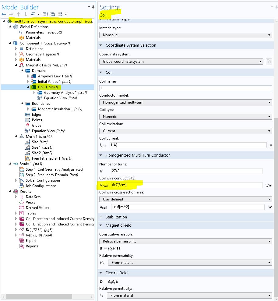

Hi Gustavo,
It is most likely you did change the electrical conductivity in the coil domain, but you would need to change the "Coil Wire Conductivity" to change the materials of the wire in the coil. See the attached image. The "Coil Wire Conductivity" is the value that is use in the software to compute the resistance and hence different current when this parameter is changed.
BR/Nirmal
Hi Gustavo, It is most likely you did change the electrical conductivity in the coil domain, but you would need to change the "Coil Wire Conductivity" to change the materials of the wire in the coil. See the attached image. The "Coil Wire Conductivity" is the value that is use in the software to compute the resistance and hence different current when this parameter is changed. BR/Nirmal
Posted: 7 years ago Mar 25, 2019, 2:38 p.m. EDT
Hello Nirmal
Thanks for your answer!
But the way I change the resistivity is by changing the Coil Wire Cross Section Area. Nothing else.
