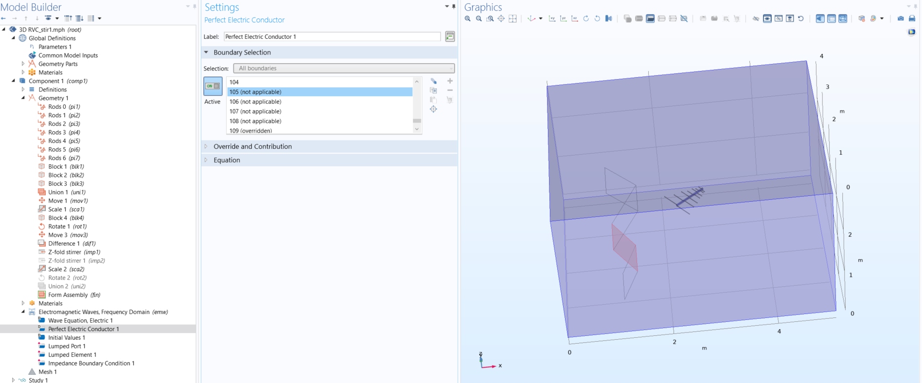

I created the geometry of the mode stirrer by defining a workplane and specifying rectangles in this workplane which I then manipulate such that they form the form of the mode stirrer. This stirrer is then considered infinitely thin to ease the computational requirements. I then try to add boundary conditions to this geometry (PEC/Impedance) but they are not applicable. I added a screenshot for clarification.
If I use very thin rectangular blocks instead of the planes I can apply the boundary conditions however the mesh becomes incredibly fine because of the thinness of the blocks causing very large computation times which I want to avoid as much as possible.

From your description alone, I already know what is going wrong. Don't model the stirrer as infinitely thin and don't try to model (mesh) the interior volume of the stirrer material either. Instead, create a stirrer with a reasonable thickness (fairly thin is ok) and subtract (using boolean difference operation) the stirrer from the chamber. This will result in (default) perfect electric conductor (PEC) boundaries on the surfaces of your stirrer. You won't be meshing the interior volume of the stirrer at all, since that is no longer part of the computational space. Now the only finely-meshed part will be the edge-surfaces of the stirrer, which shouldn't be too serious. Now, if you want to consider loss on the stirrer's surfaces, you can then define its boundaries as impedance boundaries (instead of the default PEC), and you can also assign material properties (such as a conductivity value) to those surfaces, where you normally specify materials. I hope that makes sense.

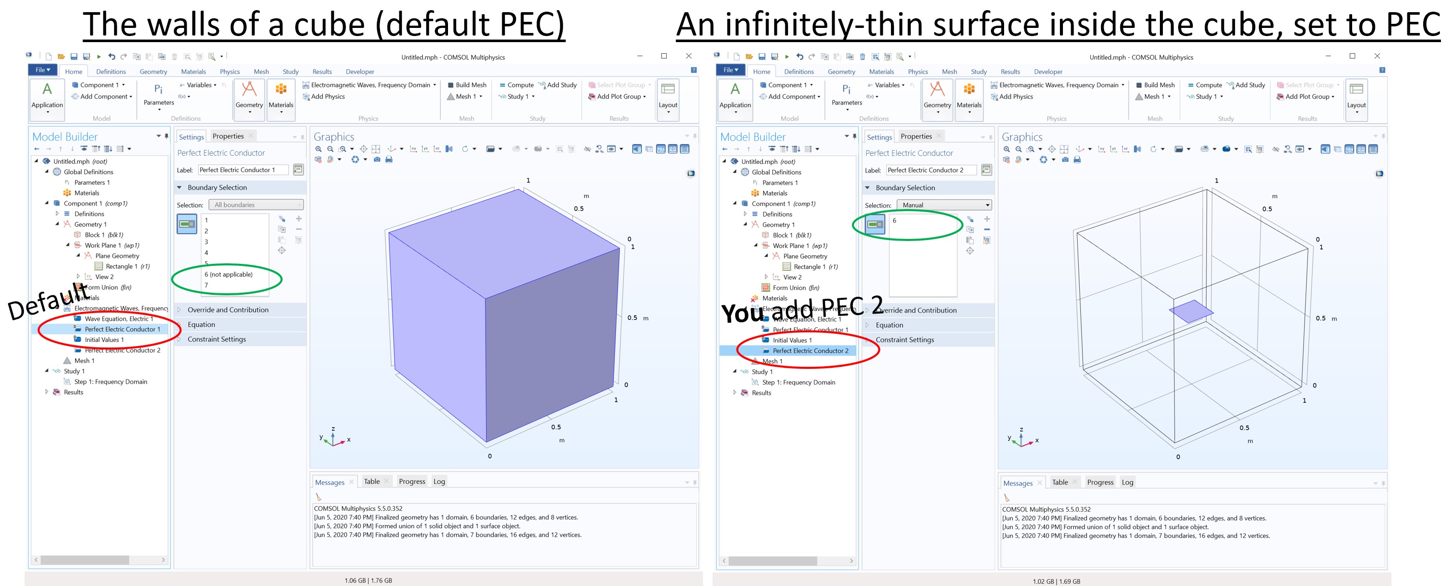

You are welcome. I should add that, in principle, you can use an infinitely thin surface, but to set it as a PEC, you will need to create a separate PEC boundary condition for it. E.g., see the attached figure for how to do that. Personally, I prefer to represent most real-world 3D objects by 3D geometries, when working in a 3D model. But again, you don't necessarily have to do that.
