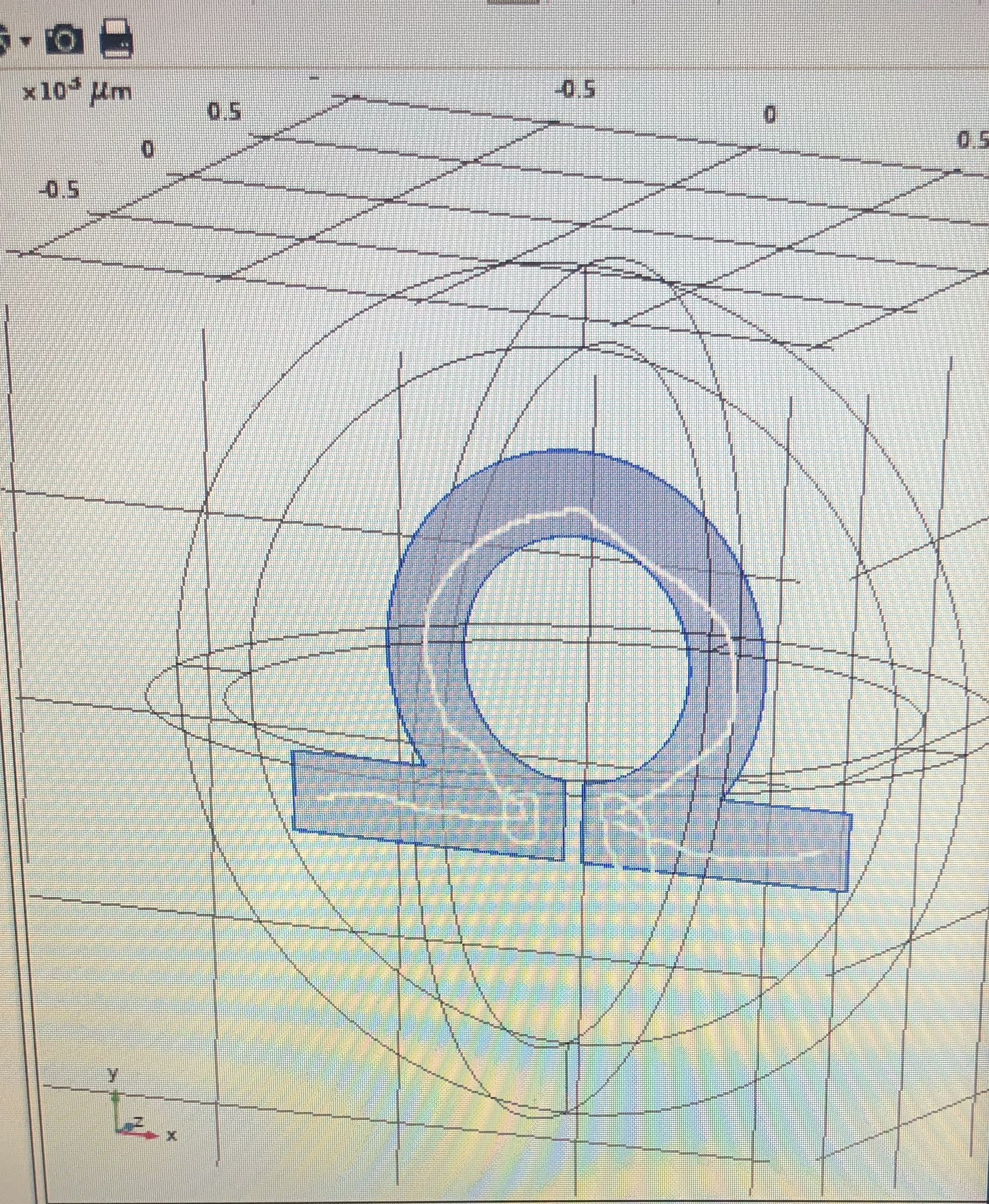

Hi everyone, Some background: I am trying to find the magnetic field of this omega shaped wire inside a sphere. I used the Electromagentic Waves, frequency domain and I am doing a frequecy domain study. Some parameters to be exact I have a current at 1 [A/m] and a frequency of 2.97e9 [Hz]. I applied a surface current density of 1[A/m](exp(i2pi/(c_const/5freq))sys2.phisys2.r where my sys2 is the given cylindrical system in the definitions. Since, my structure is irregular and has 2 straights portion and one round portion, I want to have current equal and continous at both the 2 sraight parts and the round part. I am unable to find any help anywhere. So any help is appreciated, thank you. I am attaching my mph file and a picture of how I want the current.
