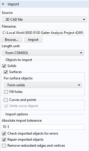

It sounds like you will need to use the Geometry tools in Comsol to fix some gaps that are preventing Comsol from recognising your imported Geometry as a solid. It is difficult to give any specific fixes. I assume you have the import settings as shown in the attched image?

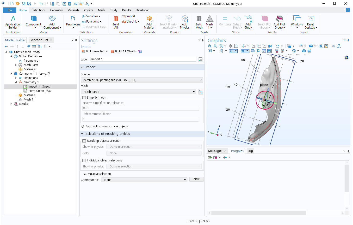

I imported a stl file like below: and it also looks like a surface, not solid.
I changed the setting like you attatched, but the error message shows: "Unrecognized file type"
I imported a stl file like below: and it also looks like a surface, not solid. I changed the setting like you attatched, but the error message shows: "Unrecognized file type"
