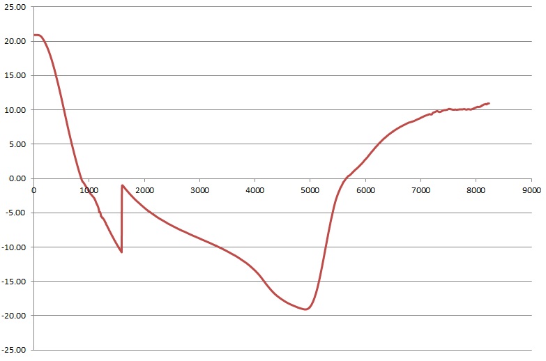

describing a simulation that took place in a climate chamber. I have attached a
graph describing the temperature on the water container surface. I want help modeling
that step-up near the 1600s mark, how should I "make the water warmer" before it starts
cooling again? I have looked into the continuous casting model for guidance and I have
used some methods described in it but I am stuck...

I would suspect some difficulties to make it a true "step" but if you use a combination with the v4 "step" function and use smooth corners, I believe you could manage, but you would need to find a way to tweak your solver to detect the step and take "small" solver steps to resolve the steep gradients
gets smoothed or averaged over instead of having that relatively steep step.
I don't mind so much at the moment because the final result is "close enough"
but, you know how it is, wanting to get it precisely right ;)I tweaked the solver to
take 0.5 sec steps around the step area but it did not do any difference.
I am starting to believe that if the water is treated as a solid, the moment of
crystallization isn't simulated correctly.

The "problem" is that in during the climate chamber simulations the water is standing still and thus allowed
to be supercooled before turning into ice. I might have to repeat the simulations trying to force the phase transition
(by jiggling the container maybe?) around the 0°C point in order to get a smoother behavior.

If you make a plot of H versus T for an equilibrium process, and take the derivative dH/dT, then you can smear the latent heat of fusion peak a bit and put it in a Cp(T) function. That is a 'normal' trick.
But with supercooling this will not work. See the picture www.esveld.org/Comsol/HvsT%20and%20TvsH.png
dH/dT is not a unique function of T. You can define dT/dH as function of H. Or even directly T als function of H(H)
Thus you need to solve a system dH/dt = PDE (T) with T=F(H) or dT/dt = f(H). Will that work in Comsol?
More physically correct would be to model the two phases ice and water and their transition reactions with entalpy change, like you can do for drying. This is a very stiff system as the local melt / freeze reactionrates are very fast. The system does not deviate from equilibrium, except when the crystallisation rate is low because of lack of nuclii.
