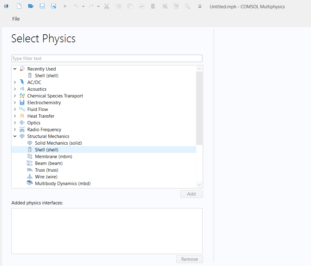

The layered shell functionality is available only in the Composite Materials Module, see the spec chart. Have you checked whether the license you are using includes the Composite Materials Module? You can find what modules are on a license under File > User and Licensed Products.

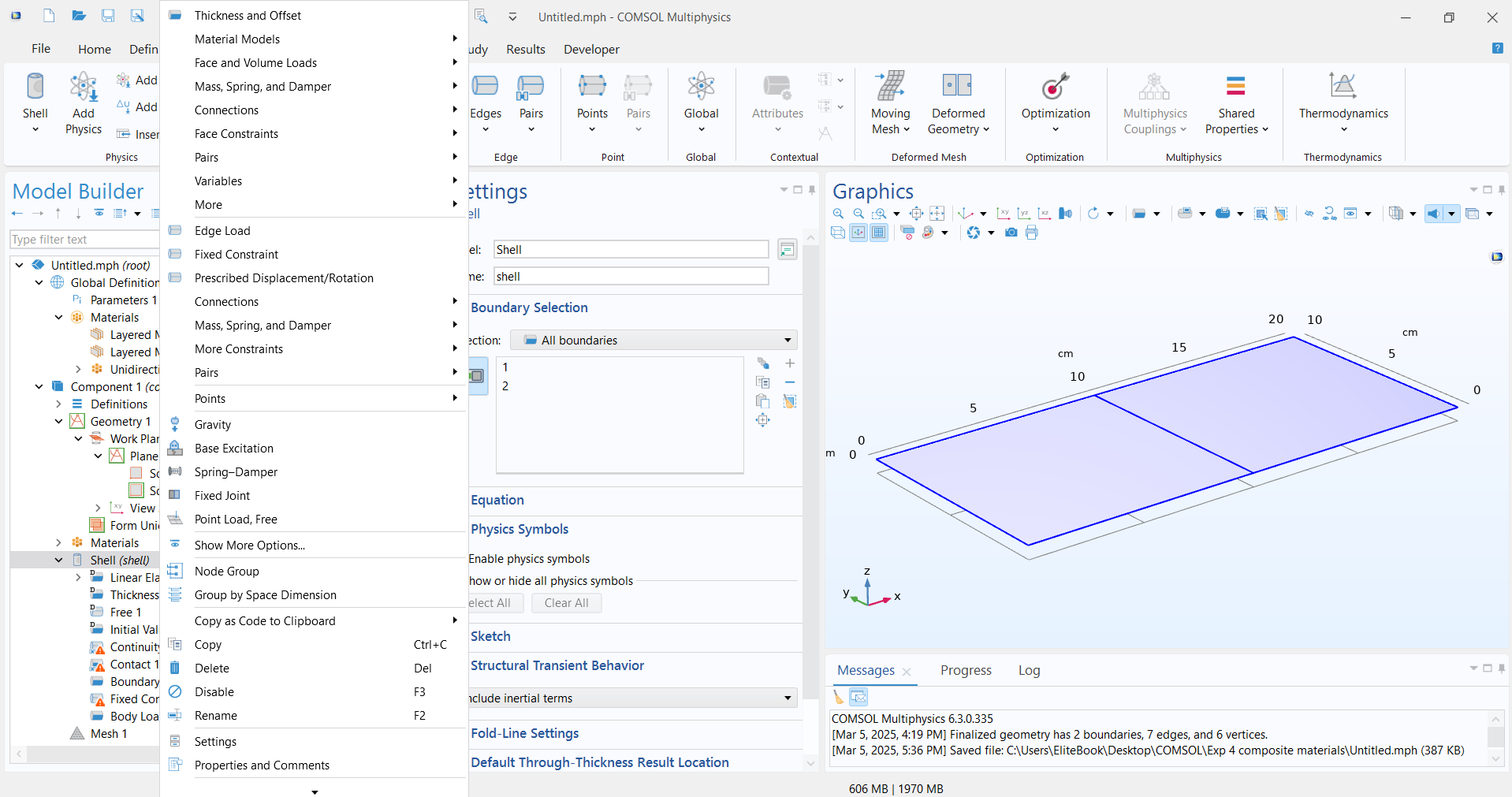

Muhammad Ali Mohsin Shahzad
Posted:
8 months ago
Mar 7, 2025, 8:36 a.m. EST
Hi Jeff,
I just checked my license and realized that it does not include this module. Is there any way to have it added? I am using Southern University Denmark’s COMSOL license.
If I manage to get this module included, it should resolve both of my issues:
The Layered Shell option under the Structural Mechanics tab, which is currently not visible.
The option to join two layers using the continuity boundary, which is also missing from my license.
I’d appreciate any guidance you can provide on this.
Best regards,
Ali
