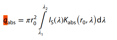

Please I need help i writing the syntax of heat absorbed (attached) and i want to know if it is volume integral or surface integral

It is neither a volume nor a surface integral. The integration runs over a wavelength interval.
