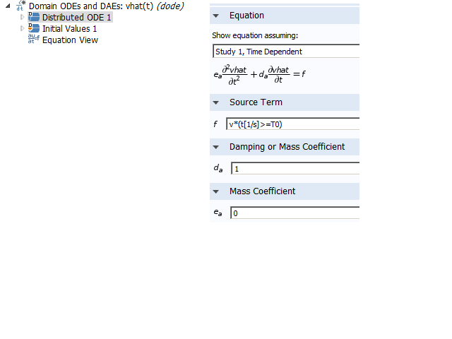

Peter,
You can use Domain ODE and DAEs (dode) interface to perform this integration, as shown in the attached image.
Sergei
Peter, You can use Domain ODE and DAEs (dode) interface to perform this integration, as shown in the attached image. Regards, Sergei
Posted: 1 decade ago Dec 9, 2014, 3:35 a.m. EST
Thank you for the comment Sergei, however as I understand it, your suggestion would make vhat define by
vhat(t) = integral of v(t) from T0 to t, (Sergei's suggestion)
and not
vhat(t) = integral of v(t) from t-T0 to t, (what I wish to achieve)
as I would like it to be.
If I am wrong please explain it to me.
The question is still open for suggestions.
Thank you for the comment Sergei, however as I understand it, your suggestion would make vhat define by vhat(t) = integral of v(t) from T0 to t, (Sergei's suggestion) and not vhat(t) = integral of v(t) from t-T0 to t, (what I wish to achieve) as I would like it to be. If I am wrong please explain it to me. The question is still open for suggestions.
