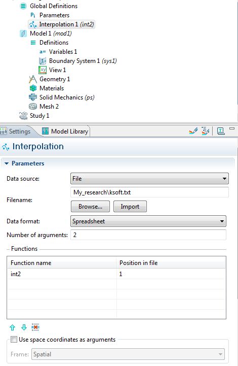

To know what the int2 is doing, I attach a screenshot.

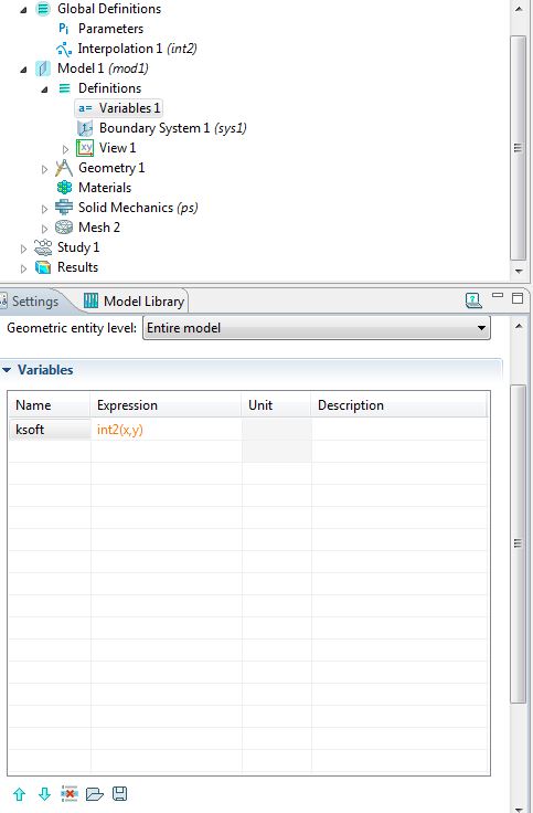

I'm not quite sure what your last 2 lines accomplish. I managed to get COMSOL to read and interpolate the .txt file by setting up int1 and the variable by hand in COMSOL, but I need to be able to set these through MATLAB (since it's going to iterate in a MATLAB loop). Any thoughts?

All the lines I gave you are to be written into a program file that you create in matlab.
If you are loading filename.m file then the interpolation command would already be in the m file itself so you probably don't need it. This script and many more would be necessary if you are writing out the entire script yourself without calling the m file.
The next line "model.study('std1').run;" is necessary because I have to run the model. What I showed you was just an extract from a much larger matlab input file. I have a lot more scripting to effect changes at every time step within a loop and therefore I run the model after changing them. I am not sure if I understood your question correctly here. So I attach here again a partial code that may help you a bit more.
