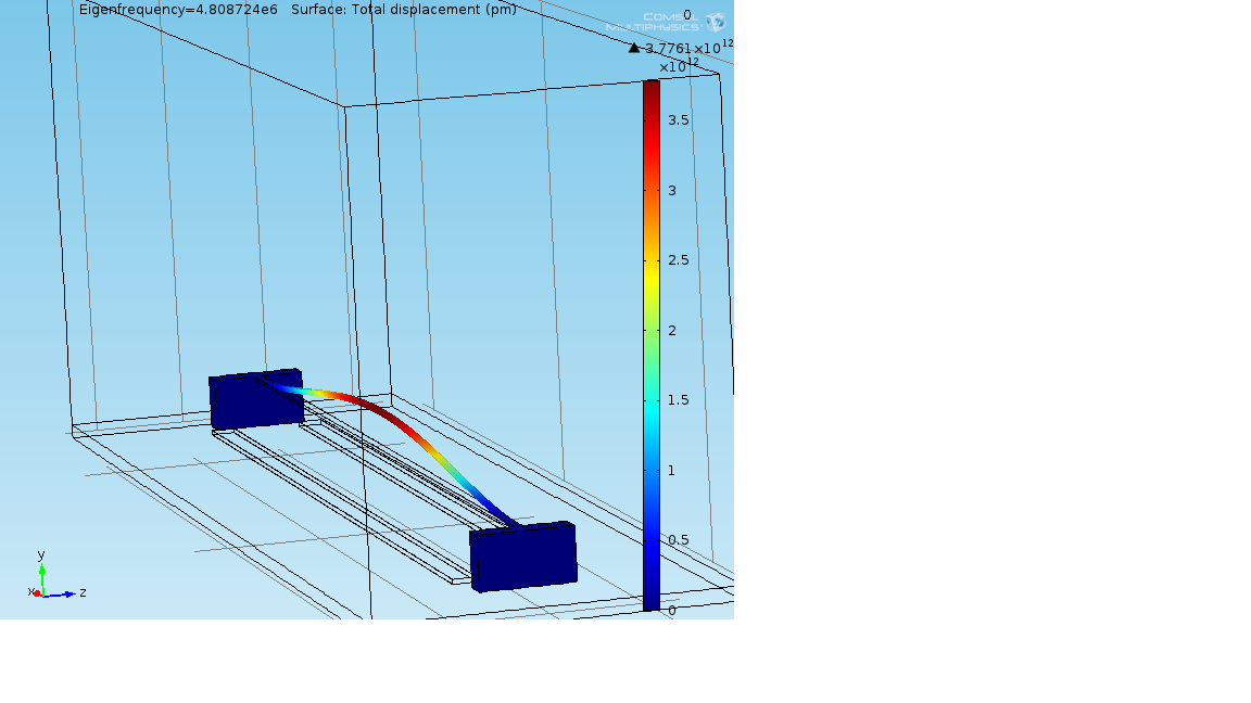

in the model attached I have a 20 micron long beam using the Solid Mechanics module to get the Eigenfrequencies. I calculated them manually using Euler-Beam theory and the first Eigenfrequency should be around 5 MHz.. Comsol calculates 4.8 MHz. I thought great result, but if you look carefully at the screenshot, you will notice that Comsol claims the displacement is on the order of meters, which is totally wrong (it is rather pico meters). I feel I am missing something fundamentally, but I cannot get Comsol to spit out the correct displacement as well. (Scaling or anything of that sort is disabled).
Thanks for advices!
Erik
In a mode shape the relative magnitude of displacements matter not the absolute value. If you scale the mode shape by any factor it is still a mode shape. COMSOL selects by default RMS (root mean square) normalization to scale mode shapes and that results in displacements of the order of unity.
Nagi Elabbasi
Veryst Engineering

Thank you! With your help I found a lot of more information on the forum about this and I think I do get it now.

There is no such thing as actual displacement in an Eigenmode study and the respective shape. It is a mathematical property of the model.
If you want to study displacement you have to run a frequency domain study and you have to excite the model some way according to your application.
Cheers
Edgar
Edgar J. Kaiser
emPhys Physical Technology
www.emphys.com
You should do a frequency domain analysis. In that case you put the harmonic loads (magnitude and frequency) and COMSOL calculates the harmonic displacements with magnitude (and phase if necessary).
Nagi Elabbasi
Veryst Engineering
Nicolas T.
What I find very confusing is that the "mode shape" plot and the normalized output don't seem to match. There should definitely be a way to plot the mode profile corresponding to the mode coordinate of your choice.
