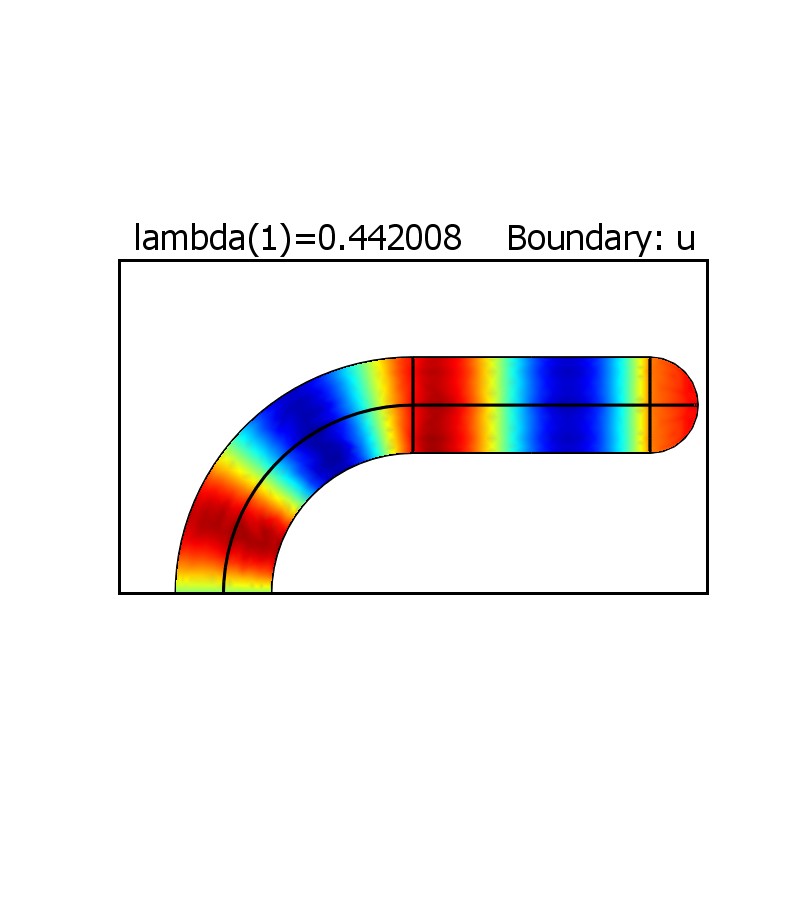

To be more clear, I tried another way to make my meshage to get better results. The tube (volume) embedded in a cube (which I call the environment and is also a volume). My calculation is simply to solve an integral on the surface of the tube. In the calcul of this integral I have to use the normal vector unit at the surface of my tube.
[I use :
Nx = (up(dom)>down(dom))*unx+(up(dom)<=down(dom))*dnx
Ny = (up(dom)>down(dom))*uny+(up(dom)<=down(dom))*dny
Nz = (up(dom)>down(dom))*unz+(up(dom)<=down(dom))*dnz]
The solution show in the attachement the constraint tension on the surface of the tube.
1) When I mesh my tube (a volume) (I do not mesh the environment), I get a really good solution and no horrible defaults appear in the solution -----> good (see the attachement)

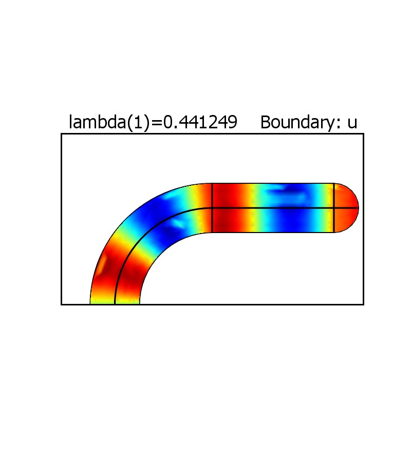

2) If I both mesh tube (fine mesh) AND cube (a volume) (coarse mesh) into which my tube is embedded, I find the same solution to the previous BUT with some horrible defaults located in the solution ! (see the attachement)
Unfortunately I need this additional environment for the rest of my work.
I do not understand why the fact to mesh the external environment gives these defaults in the solution ! The presence of the mesh of the cube should not be a problem... More, I get some results completely incoherent when the tube is meshed only in surface ...and the normal vectors (Nx, Ny, Nz) are not good oriented.
